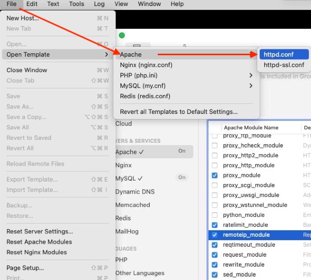

1. In MAMP Pro, enable remoteip_module in Apache.
Mamp Pro Remote Ip Apache

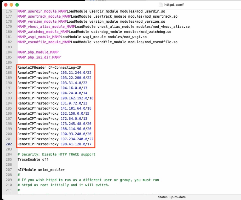

2. Open httpd.conf template.
Mamp Pro Apache Httpd Conf
Mamp Pro Apache Httpd Conf (101.77 KiB) Viewed 112455 times
3. Update your LogFormat log replacing %h with %a. (this will show client IP address of the request in log files) Example:
Code: Select all
LogFormat "%a %l %u %t \"%r\" %>s %O \"%{Referer}i\" \"%{User-Agent}i\"" combined

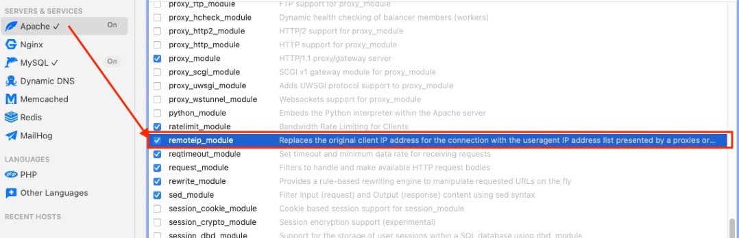

4. Configure your trust proxy addresses accordingly.
Code: Select all
RemoteIPHeader CF-Connecting-IP
RemoteIPTrustedProxy 192.0.2.1 (example IP address)
RemoteIPTrustedProxy 192.0.2.2 (example IP address)
Mamp Pro Apache Trusted Ip Proxy Address
Mamp Pro Apache Trusted Ip Proxy Address (133.05 KiB) Viewed 112455 times
