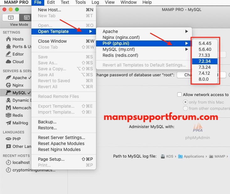

Re: Where is the PHP.INI file used by MAMP?
MAMP or MAMP Pro?
You need to edit the PHP.INI master template file

MAMP, so far. Thanks for the reply, the screenshot you gave me was from MAMP Pro, i don't see that menu option in straight MAMP, i'll see if i can find it in the MAMP installation itself. If i'm looking for something that's not there, please let me know.mampsupportmod wrote: Tue May 25, 2021 11:04 am MAMP or MAMP Pro?
