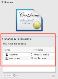

I have to give my Mac user account read access to Let's Encrypt's privkey.pem otherwise MAMP cannot load the SSL file as part of the chain. These certificates issued before would automatically give the Mac user account read access but not anymore. Going into each privkey to set permissions is annoying after a renewal period. Anyone else having this issue?
Lets Encrypt Priv Key No Access
Lets Encrypt Priv Key No Access (19.44 KiB) Viewed 106216 times

I haven't. privkey.pem keys issued by certbot still appear to be unreadable by MAMP Pro. You will need to manually adjust the key's permissions in order to apply and save your key to a MAMP host. According to Let's Encrypt, the keys are being issued with the correct permissions.
