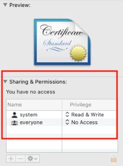

I have to give my Mac user account read access to Let's Encrypt's privkey.pem otherwise MAMP cannot load the SSL file as part of the chain. These certificates issued before would automatically give the Mac user account read access but not anymore. Going into each privkey to set permissions is annoying after a renewal period. Anyone else having this issue?

I haven't. privkey.pem keys issued by certbot still appear to be unreadable by MAMP Pro. You will need to manually adjust the key's permissions in order to apply and save your key to a MAMP host. According to Let's Encrypt, the keys are being issued with the correct permissions.

I have found in MAMP 7.1.3 I can give read/write permissions to me for the Live and Archive directories, and MAMP can read and save the cert and privkey, but not the chain, all from the live folder. When I test the cert, it says it issued from E5, not from MAMP but without the chain file it still shows up as not trusted in https://www.sslshopper.com/ssl-checker.html.
