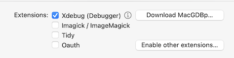

I'm not sure about the 7.x Free version user interface, but in 6.x Pro enabling imagack is done via the PHP section.
Mamp Ui Php Imagick
Mamp Ui Php Imagick (22.38 KiB) Viewed 53012 times
