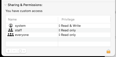

Whats permissions you used? Please open one of the keys (Right click -> Get Info) and show me permissions. You will still have to give your mac user access to the private key if you are using (in archive folder where real keys reside).
In my case, I use the alias' in live folder (i do not check the box to automatically resolve as you shouldnt need to)
See permissions for my key example:

Thanks for the quick reply.
Everything I read says do not touch the archive folder as the live folder is liked to the current cert. That way when the certs change the live folder will reflect that and I won't have to update it in the MAMP interface.
