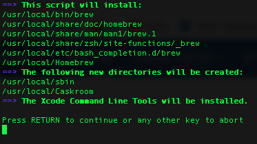

2. The HomeBrew website tells us to use the following command in Terminal to install. Visit the HomeBrew website to confirm you are using the latest command. Type the following command in Terminal:
Code: Select all
/usr/bin/ruby -e "$(curl -fsSL https://raw.githubusercontent.com/Homebrew/install/master/install)"
Mac Os X Install Homebrew
Mac Os X Install Homebrew (29.13 KiB) Viewed 92069 times
3. Hit return to continue installing HomeBrew. You will need to enter your Mac OS X account password. The HomeBrew install will take about 5-10 minutes depending on your Internet speed and whether or not you have command line tools already installed.

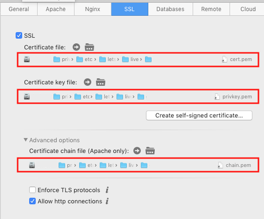

1. Now, we'll add our SSL certificates to our MAMP Pro website host. Select your website host in MAMP Pro -> SSL Tab -> Check SSL Box and select your MAMP Pro SSL certificates accordingly to add them to your host. We want to select the SSL Alias' files in the live folder so when we auto-renew our SSL's, we don't have to update the files again in MAMP Pro. Open each SSL certificate file in MAMP Pro accordingly.
SSL Live Folder Path: ‎⁨
Code: Select all
\YOUR-USER\private⁩\etc⁩\⁨letsencrypt⁩\⁨live⁩
Do not check Automatically resolve selected alias or symbolic link when clicking 'Choose'.
Mamp Pro Auto Resolve Alias Symbolic Link
Mamp Pro Auto Resolve Alias Symbolic Link (20.01 KiB) Viewed 92069 times
The MAMP Pro Certificate file is:
Code: Select all
 cert.pem
The MAMP Pro Key file is:
Code: Select all
privkey.pem
The MAMP Pro Certificate Chain file is:
Code: Select all
chain.pem
Mamp Pro Set Apache Ssl Certificate
Mamp Pro Set Apache Ssl Certificate (69.93 KiB) Viewed 92069 times
2. Click Save. MAMP Pro will restart services.

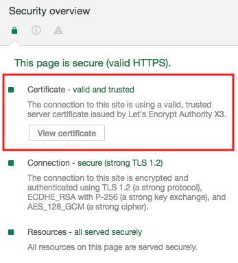

1. Let's ensure we correctly installed the SSL certificates in MAMP Pro for our website. Browse to your website using a browser such as Google Chrome to display the SSL certificate. You should see similar language below.
The connection to this site is using a valid, trusted server certificate issued by Let's Encrypt Authority X3.
Mamp Pro Ssl Certificate Valid
Mamp Pro Ssl Certificate Valid (59.71 KiB) Viewed 92069 times
