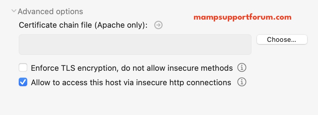

First, I checked MAMP PRO -> Hosts -> SSL and ensured Allow to access this host via insecure http connections was enabled.
Mamp Pro Allow To Access This Host Via Insecure Http Connections
Mamp Pro Allow To Access This Host Via Insecure Http Connections (61.44 KiB) Viewed 194574 times

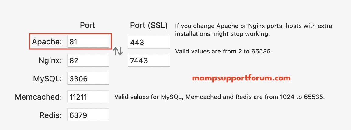

Then, I opened MAMP Pro -> Ports and User and discovered Apache non-SSL connections for MAMP Pro was running on port 81 instead of 80! I had MAMP Pro to always use port 80.
Mamp Pro Apache Port 81 Macos
Mamp Pro Apache Port 81 Macos (75.91 KiB) Viewed 194574 times
I coordinated the timing of the redirects not working after I performed a macOS system update. Sure enough, I discovered the macOS update re-enabled the default macOS Apache server on port 80 forcing MAMP Pro to use the next available port, 81.
The solution was simple - disable the default macOS Apache server so MAMP Pro Apache can run on port 80 again.
