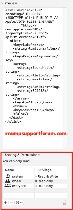

3. Put both files in
Code: Select all
/Library/LaunchDaemons
4. Make the plists root:wheel so macOS has permission to load them on startup. In Terminal type:
sudo chown -R root:wheel /Library/LaunchDaemons/limit.maxproc.plist
sudo chown -R root:wheel /Library/LaunchDaemons/limit.maxfiles.plist
Maxproc Maxfiles Plist Root Wheel Permissions Macos Monterey
Maxproc Maxfiles Plist Root Wheel Permissions Macos Monterey (60.81 KiB) Viewed 21369 times

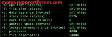

6. Confirm new limits are in place. In Terminal type: ulimit -a
Code: Select all
-t: cpu time (seconds)              unlimited
-f: file size (blocks)              unlimited
-d: data seg size (kbytes)          unlimited
-s: stack size (kbytes)             8176
-c: core file size (blocks)         0
-v: address space (kbytes)          unlimited
-l: locked-in-memory size (kbytes)  unlimited
-u: processes                       4000
-n: file descriptors                64000
Ulimit Macos Monterey New Limits
Ulimit Macos Monterey New Limits (27.38 KiB) Viewed 21365 times
Note: It appears macOS Monterey may have a limit of setting a maximum of 4000 processes. In addition, you may need to disable SIP (System Integrity Protection in macOS to allow the higher limits. Follow this guide.
