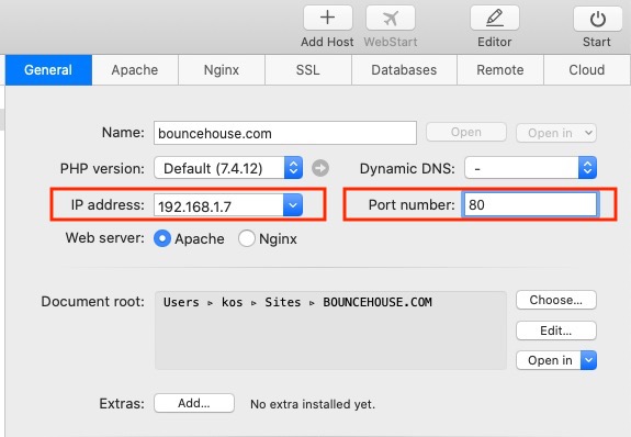

So as long as you've set the IP and port (port you have MAMP using) of your host on the computer running your MAMP host, you can access the site the same way by typing the MAMP's computer hostname and appending the port. It's also documented here.
The latest version of MAMP doesn't seem to have the "Xip.io" name resolution feature anymore where this used to let you broadcast the MAMP hostname across your network.
Mamp Pro Access Site Over Lan Set Ip Address.jpg (47.84 KiB) Viewed 15884 times
