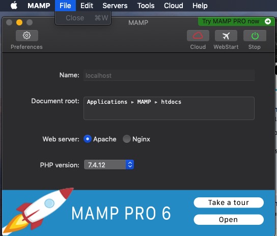

Re: Terminal no longer importing
Thank you for your suggestion
I solved my problem by doing a global dump of all my databases and reinstalling MAMP from scratch.
By the way, there is no "Reset" option in my File menu
Ah, not MAMP Pro
